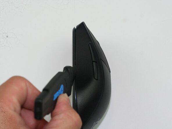

  4. SteelSeries Rival 3 Wireless Scroll Wheel Replacement: step 4, image 1 of 2 SteelSeries Rival 3 Wireless Scroll Wheel Replacement: step 4, image 2 of 2
    • Using a prying tool, gently pry the mouse seam open.
    • Gently lift the top shell from the mouse, to locate the scroll wheel.
    • Carefully remove the three 5 mm screws using a Phillips #0 screwdriver.
