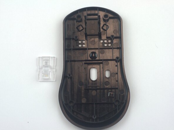

    1. SteelSeries Rival 3 Wireless Optical Sensor Lens Replacement, Optical Sensor Lens: step 7, image 1 of 2 SteelSeries Rival 3 Wireless Optical Sensor Lens Replacement, Optical Sensor Lens: step 7, image 2 of 2
      • Use tweezers to carefully lift the optical sensor lens out of the mouse housing.
