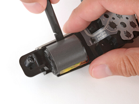

    1. Steam Controller (2nd Gen, 2026) Right Rumble Motor Replacement, Apply isopropyl alcohol: step 21, image 1 of 2 Steam Controller (2nd Gen, 2026) Right Rumble Motor Replacement, Apply isopropyl alcohol: step 21, image 2 of 2
      • Each rumble motor is firmly glued in place.
      • Apply a few drops of isopropyl alcohol to the inner edge of the right rumble motor well.
      • Wait one minute to allow the alcohol to soften the adhesive securing the motor.
      Ask FixBot
    2. Steam Controller (2nd Gen, 2026) Right Rumble Motor Replacement, Pry up the rumble motor: step 22, image 1 of 3 Steam Controller (2nd Gen, 2026) Right Rumble Motor Replacement, Pry up the rumble motor: step 22, image 2 of 3 Steam Controller (2nd Gen, 2026) Right Rumble Motor Replacement, Pry up the rumble motor: step 22, image 3 of 3
      • Use the flat end of a spudger to pry up inner edge of the rumble motor, applying constant pressure until the adhesive separates.
      • The midframe will bend slightly—that's fine. If it feels like the plastic is deforming, stop and apply a few more drops of alcohol and try again.
      Ask FixBot

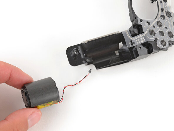

    3. Steam Controller (2nd Gen, 2026) Right Rumble Motor Replacement, Remove the rumble motor: step 23, image 1 of 2 Steam Controller (2nd Gen, 2026) Right Rumble Motor Replacement, Remove the rumble motor: step 23, image 2 of 2
      Tool used on this step:
      Tesa 61395 Tape
      $2.95
      Buy
      • Remove the rumble motor, guiding its cable through the cutout.
      • During reassembly:
      • Use a spudger and tweezers to remove any leftover bits of adhesive.
      • Remove any adhesive residue with isopropyl alcohol and a microfiber cloth.
      • You'll need to secure the motor with strong double sided tape. If your replacement motor comes with adhesive pre‑installed, remove the liner. If it doesn't, apply tape to the motor's corresponding spot in the well.
      • Thread the wire through its cutout and press the motor into place so the board is on the outer edge.
