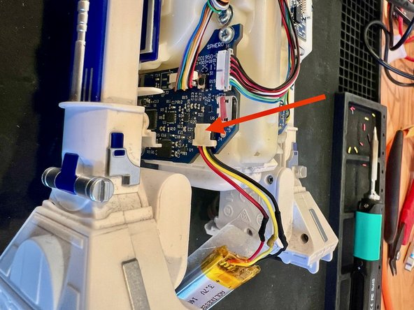

Sphero R2-D2 Lithium Polymer Battery Replacement
The original battery is a 3.7V 1400mAh battery manufactured by Ascent Batteries.
Model: ABI-H832370
Original battery dimensions:
H 6.35 mm
W 22.22 mm
L 69.85 mm
This battery also has a yellow wire for an NTC thermistor embedded in the battery pack to monitor battery temperature while charging.
Replacement Battery
Amazon: https://www.amazon.com/dp/B0CSC3WYTZ
It's sold as a "3.7V Rechargeable Lipo Battery 1400mAh Replacement for Logitech MX Keys Mini Minimalist Wireless Illuminated Keyboard"
It's a little bit smaller in length than the original battery but it fits fine.
Note: Please leave a comment if you were able to find other suitable replacement batteries.

      • Carefully unplug and remove the original battery from the slot. The original battery connector is proprietary and needs to be spliced into the new battery. Cut the connectors from both batteries. Splice the original battery connector with the replacement battery.
      • Insert the new replacement battery into the slot.
      • Plug in the battery connector.

Hey there, thanks for all the info here! One question, what type/size wire connectors did you use to splice the old wires to the new battery?
Rsquared1179 - Reply Share
Hi! Both battery wires are the same. You just have to cut the wires - keeping the original propriety connector - of the original battery and solder the wires to the replacement battery wires - which, of course, you also have to cut the wires to remove the connector that comes with it. You can use heat shrinking tubing after soldering the wires. I hope it helps!
JP Legat - Reply Share
Hi there
Will this fit into R2Q5? It seems to me the original battery comes with 5.18Wh. The Amazon replace ment is 5.55Wh. Does that make any difference?
Thanks a lot
Barry - Reply Share
Watt-hour (Wh) is a unit of energy that measures how much power a battery can deliver over a specific period, typically one hour. It should work, just double-check the specs (voltage, thermistor) of the battery the R2Q5 unit uses.
