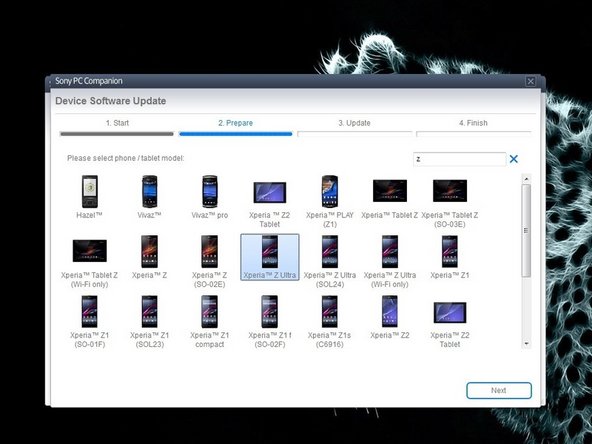

  5. Sony Xperia Z Ultra - Password Removal, Firmware update: step 5, image 1 of 2 Sony Xperia Z Ultra - Password Removal, Firmware update: step 5, image 2 of 2
    • You phone must be at last 80% charged.
    • Choose the model.
    • Attention!!! You must choose the right model.
