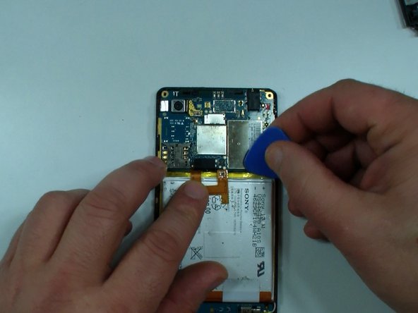

    2. Sony Xperia E3 Touch Screen Replacement: step 4, image 1 of 3 Sony Xperia E3 Touch Screen Replacement: step 4, image 2 of 3 Sony Xperia E3 Touch Screen Replacement: step 4, image 3 of 3
      • With a hair dryer or heat gun warm the glass, at first for about 2-3 minutes.
      • Use a thin plastic tool, like a plastic pick and start the separation from the underside.
      • Do this very slow and periodically warm the glass!
      • At the beginning you have to separate the touch screen glass from the main frame.
