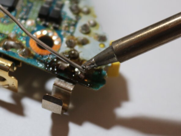

    1. Sony Walkman D-EJ360 Battery Terminal Replacement, Battery Terminal: step 10, image 1 of 2 Sony Walkman D-EJ360 Battery Terminal Replacement, Battery Terminal: step 10, image 2 of 2
      • Apply flux to the solder joints of the damaged battery terminal.
      • Heat the solder joint using soldering iron until liquid, and use a desoldering pump to suck the solder away from the terminal. There should be a visible void between the terminal and the motherboard.
      • Clean the hot end of the soldering iron between each joint. This will help reduce any excess solder from filling the joint. This can be done with either wet sponge or brass/copper shavings.
      • Repeat for the 3 joints of the battery terminal.
      • Be careful to not hold heat for too long as the soldering iron can burn the motherboard.
      Ask FixBot
    2. Sony Walkman D-EJ360 Battery Terminal Replacement: step 11, image 1 of 1
      • Use tweezers to remove the battery terminal from the motherboard. There may be a small remnant of solder holding the terminal. You may need to torque the terminal side to side in order to get it to break free.
      • Caution: the terminal may still be hot. Avoid setting the terminal on a flammable or heat sensitive surface.
      Ask FixBot
    3. Sony Walkman D-EJ360 Battery Terminal Replacement: step 12, image 1 of 1
      • Apply flux to traces, place solder wick on traces, and press soldering iron against the solder wick and carefully scrub the traces for about 3-5 seconds.
      • The traces should be visibly silver with a hole in the center. Make sure there is no solder filling in the trace, as the terminal must be able to go through the holes.
      Ask FixBot
    4. Sony Walkman D-EJ360 Battery Terminal Replacement: step 13, image 1 of 1
      • Apply flux to the three traces of the terminal.
      • Apply a small amount of solder to the hot end of the soldering iron until a small drop of solder is on the iron.
      • Press said drop of solder against the terminal. If the solder flows, the the trace will have no gaps around the terminal pin. You may need to add additional solder to the trace. to make a full connection.
      • Clean the soldering iron hot end, and repeat for all three traces.
      • Make sure to not bridge any traces, and to not bump any adjacent electronics to the terminal.
      • If too much solder is on the trace, or a trace gets bridged, clean the soldering iron, apply flux to the solder joint, and use the soldering iron to wick up some of the solder. It may take multiple attempts to remove the excess solder. Make sure to clean the hot end between each attempt.
