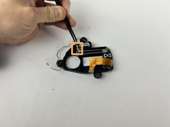

  8. Sony Walkman D-E356CK Disk Reader Replacement, Disk Reader: step 8, image 1 of 2 Sony Walkman D-E356CK Disk Reader Replacement, Disk Reader: step 8, image 2 of 2
    • Carefully take out the clear plastic piece found in the image.
    • Use the tweezers to carefully remove the clear yellow gear.
    Ask FixBot
  9. Sony Walkman D-E356CK Disk Reader Replacement: step 9, image 1 of 1
    • Remove the rod with a white gear attached at the end.
    Ask FixBot
