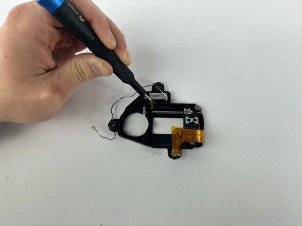

  7. Sony Walkman D-E356CK Disk Reader Motor Replacement, Disk Motor: step 7, image 1 of 3 Sony Walkman D-E356CK Disk Reader Motor Replacement, Disk Motor: step 7, image 2 of 3 Sony Walkman D-E356CK Disk Reader Motor Replacement, Disk Motor: step 7, image 3 of 3
    • Remove the disk motor housing from front panel and flip it over.
    • Remove the 5mm screws from the disk motor.
    Ask FixBot
  8. Sony Walkman D-E356CK Disk Reader Motor Replacement, Disk Reader: step 8, image 1 of 2 Sony Walkman D-E356CK Disk Reader Motor Replacement, Disk Reader: step 8, image 2 of 2
    • Carefully take out the clear plastic piece found in the image.
    • Use the tweezers to carefully remove the clear yellow gear.
    Ask FixBot
  9. Sony Walkman D-E356CK Disk Reader Motor Replacement: step 9, image 1 of 1
    • Remove the rod with a white gear attached at the end.
    Ask FixBot
  10. Sony Walkman D-E356CK Disk Reader Motor Replacement, Disk Reader Motor: step 10, image 1 of 3 Sony Walkman D-E356CK Disk Reader Motor Replacement, Disk Reader Motor: step 10, image 2 of 3 Sony Walkman D-E356CK Disk Reader Motor Replacement, Disk Reader Motor: step 10, image 3 of 3
    • Remove 5 mm Phillips screw underneath the metal motor.
    • Remove the disk reader motor.
