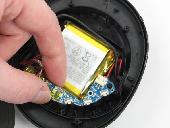

  8. Sony WH-CH710N Right Speaker Replacement: step 8, image 1 of 3 Sony WH-CH710N Right Speaker Replacement: step 8, image 2 of 3 Sony WH-CH710N Right Speaker Replacement: step 8, image 3 of 3
    • Using your fingers or a pair of tweezers, gently grasp the circuit board and lift it out of the ear cup.
    • You will not be able to remove it completely because the wires are still connected.
    • If possible, place the circuit board in the Helping Hands or a safe place to desolder the speaker wires.
    • The next step shows the speaker wires being desoldered while the board is still inside the ear cup. However, it is easier and safer to solder away from the headphones.

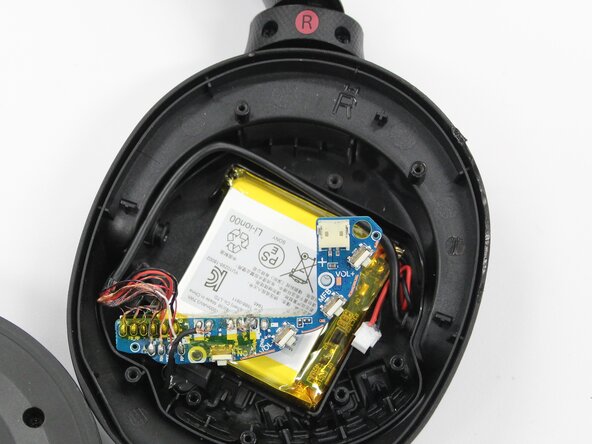

  9. Sony WH-CH710N Right Speaker Replacement: step 9, image 1 of 2 Sony WH-CH710N Right Speaker Replacement: step 9, image 2 of 2
    • Use a soldering iron to remove the 4 wire connections below the inner plate.
    • With the bottom of the headphone facing you, the wires are connected left to right in this order: black wire --> green, copper | white wire --> red, copper.
    Ask FixBot
