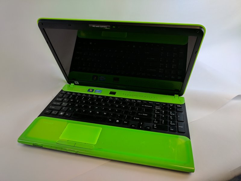

Sony Vaio VPCCB290X LCD Screen Replacement
Introduction
Go to step 1 ↓
Watch out for applying to much pressure to your screen because it is possible to damage the screen by applying pressure or by bending the screen.

    1. Sony Vaio VPCCB290X LCD Screen Replacement, LCD Screen: step 1, image 1 of 1
      • First make sure the laptop is off and closed.
      Ask FixBot
    2. Sony Vaio VPCCB290X LCD Screen Replacement: step 2, image 1 of 1
      • Unlock the battery and push the release lever to remove the battery from the laptop.
      Ask FixBot
    3. Sony Vaio VPCCB290X LCD Screen Replacement: step 3, image 1 of 2 Sony Vaio VPCCB290X LCD Screen Replacement: step 3, image 2 of 2
      • Remove the screws marked in red to remove the hard drive cover and the screws marked in blue to loosen the hard drive. Then gently slide the hard drive out.
      Ask FixBot
    4. Sony Vaio VPCCB290X LCD Screen Replacement: step 4, image 1 of 1
      • Remove all the screws that hold the plastic bottom on. There are some more screws that cant be seen in the photo.
      Ask FixBot
    5. Sony Vaio VPCCB290X LCD Screen Replacement: step 5, image 1 of 1
      • Gently pry up the plastic bottom and if it feels like it is resisting check the surrounding areas for more screws.
      Ask FixBot
    6. Sony Vaio VPCCB290X LCD Screen Replacement: step 6, image 1 of 1
      • Now that the backing plate is off make sure to be careful of the Motherboard and its components from being damaged. from here on out it is recommended that you wear a anti static bracelet or at the very least touching something metal to remove any static electricity that you may have built up
      Ask FixBot
    7. Sony Vaio VPCCB290X LCD Screen Replacement: step 7, image 1 of 1
      • Use a common or lat head screw driver to gently untangle the wires from their paths.
      Ask FixBot
    8. Sony Vaio VPCCB290X LCD Screen Replacement: step 8, image 1 of 2 Sony Vaio VPCCB290X LCD Screen Replacement: step 8, image 2 of 2
      • You will need to unscrew this small circuit board and fold it up to get the wires out from under it.
      Ask FixBot
    9. Sony Vaio VPCCB290X LCD Screen Replacement: step 9, image 1 of 1
      • Disconnect the screen from the motherboard.
      Ask FixBot
    10. Sony Vaio VPCCB290X LCD Screen Replacement: step 10, image 1 of 1
      • They are two hinges that hold the screen on. Make sure to pay attention to where the screws come from in order to put them back and to make installation easier.
      Ask FixBot
    11. Sony Vaio VPCCB290X LCD Screen Replacement: step 11, image 1 of 1
      • By folding up the hinges the screen will simply slide away from the body of the computer and you can then put the new screen into place.
      Ask FixBot
