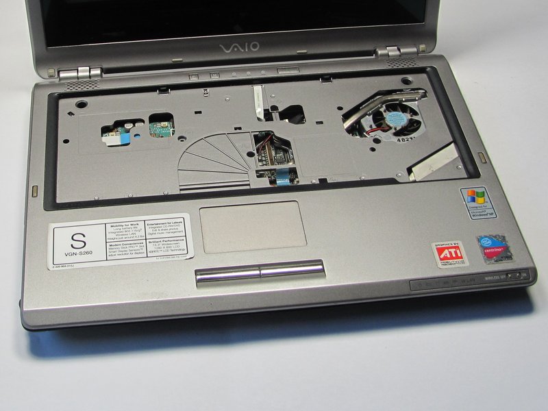

    3. Sony Vaio VGN-S260 Upper Casing Replacement: step 9, image 1 of 1
      • Find and remove 5 screws (they all have arrows next to them) from cover.
      Ask FixBot
    4. Sony Vaio VGN-S260 Upper Casing Replacement: step 10, image 1 of 3 Sony Vaio VGN-S260 Upper Casing Replacement: step 10, image 2 of 3 Sony Vaio VGN-S260 Upper Casing Replacement: step 10, image 3 of 3
      • Flip the laptop over so the Vaio logo is face up.
      • Use the spudger to pop up the upper casing.
      • Do not lift too much as the upper casing is attached to wires underneath.
      • Remove the wires that are attaching the upper casing to the motherboard.
      Ask FixBot
    5. Sony Vaio VGN-S260 Upper Casing Replacement: step 11, image 1 of 1
      • Remove the upper casing.
      Ask FixBot
