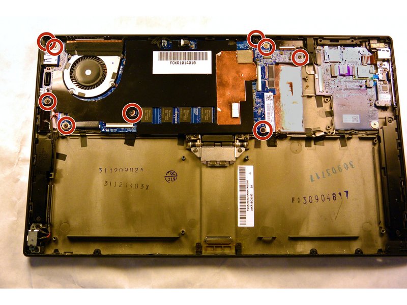

    1. Sony Vaio Tap 11 Motherboard Replacement, Motherboard: step 6, image 1 of 1
      • Remove the nine 3 mm Phillips #000 screws holding in the motherboard.
      Ask FixBot
