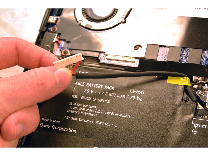

    1. Sony Vaio Tap 11 Audio Jack Replacement, Audio Jack: step 4, image 1 of 1
      • After removing the screen, disconnect the battery from the motherboard to avoid shock or the shorting of circuits.
