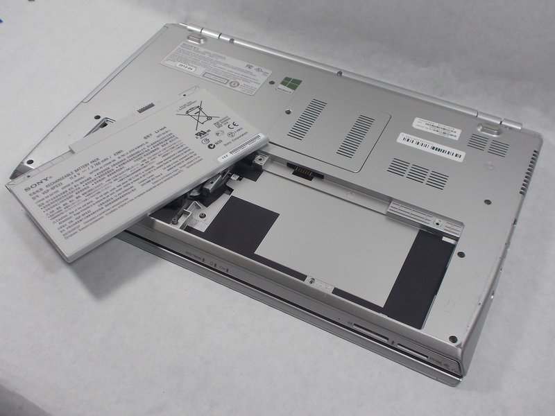

      • Flip the laptop over so that the battery on the underside of the device is revealed.
      • Unscrew the two 11mm slotted silver screws that can be found at the top of the battery.
      Ask FixBot
    2. Sony Vaio SVT151A11L Battery Replacement: step 2, image 1 of 3 Sony Vaio SVT151A11L Battery Replacement: step 2, image 2 of 3 Sony Vaio SVT151A11L Battery Replacement: step 2, image 3 of 3
      • Wedge the plastic opening tool between the back panel and the battery on the top left side of the device.
      • Push down on the plastic opening tool until the battery lifts from the back of the laptop.
      • Grab the battery and remove it from the device.
