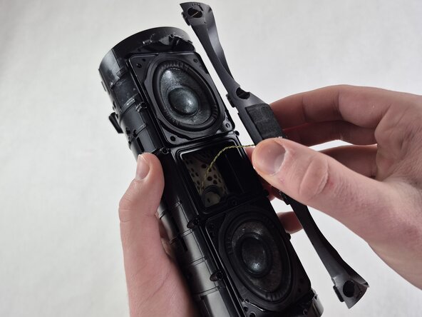

    5. Sony SRS-XB23 Battery Replacement: step 8, image 1 of 2 Sony SRS-XB23 Battery Replacement: step 8, image 2 of 2
      • Remove the eight 8.0 mm PH1 screws holding the front plate of the speakers in place.
      • Gently remove the face plate.
      • Do NOT pull on the front plate as it is connected to the motherboard with a wire.
      • Set the face plate close to the side of the speaker.
      • Once the upper speaker driver is removed, you can disconnect the cable connecting the faceplate to the circuit board.

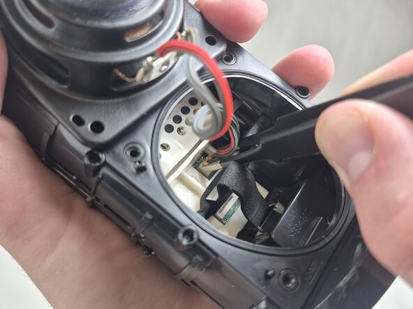

    8. Sony SRS-XB23 Battery Replacement: step 11, image 1 of 3 Sony SRS-XB23 Battery Replacement: step 11, image 2 of 3 Sony SRS-XB23 Battery Replacement: step 11, image 3 of 3
      • Remove the lower speaker driver from the frame.
      • Grip the orange connector on the lower speaker cable with tweezers and gently wiggle it while pulling outward to disconnect it.

    1. Sony SRS-XB23 Battery Replacement, Motherboard: step 12, image 1 of 1
      • Use tweezers to firmly grip the ribbon cable at the bottom of the speaker opening and gently pull it straight out of the socket.

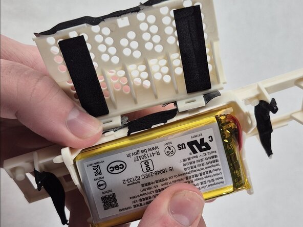

    1. Sony SRS-XB23 Battery Replacement, Battery: step 16, image 1 of 1
      • Using the small plastic spudger, pry up the two white clips.
      • The black tape will rip and will not be repairable. Do not worry, as it is not necessary to put the device back together.
      Ask FixBot
    2. Sony SRS-XB23 Battery Replacement: step 17, image 1 of 1
      • Open the battery case, it should swing open like a door.
      • Grasp the battery on either side and pull directly out.
      • Since the battery connection was removed in a previous step, there is nothing else holding the battery in place.
