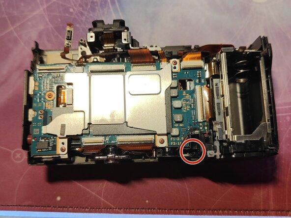

  31. Sony NEX-7 Sony NEX-7 Shutter Assembly Replacement, Remove the metal shield and motherboard: step 31, image 1 of 3 Sony NEX-7 Sony NEX-7 Shutter Assembly Replacement, Remove the metal shield and motherboard: step 31, image 2 of 3 Sony NEX-7 Sony NEX-7 Shutter Assembly Replacement, Remove the metal shield and motherboard: step 31, image 3 of 3
    • Remove the 4 red M1.4 X 2.5 screws with a JIS 00 screwdriver marked with red circles in Picture 1.
    • Remove the metal shield.
    • First open the latches on the FPC connectors marked with red rectangles in the direction of the arrows as shown in Picture 3.
    • The FPC connectors marked with orange rectangles don't have locking tabs, you only have to remove them in the direction of the arrows as shown in Picture 3.
    • I suggest removing the one on the left with a pair of tweezers, by putting both of them on the two little tabs and pushing in the direction of the arrows, and the other one (on the right) just hold it with your fingers and pull it in the direction of the arrow.
    • Please don't try to remove the motherboard until you have read the next step.

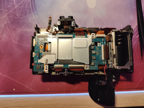

  32. Sony NEX-7 Sony NEX-7 Shutter Assembly Replacement, Removing the motherboard 2: step 32, image 1 of 3 Sony NEX-7 Sony NEX-7 Shutter Assembly Replacement, Removing the motherboard 2: step 32, image 2 of 3 Sony NEX-7 Sony NEX-7 Shutter Assembly Replacement, Removing the motherboard 2: step 32, image 3 of 3
    • Carefully lift the motherboard from the left side and tilt it to the right, there are still 2 flex cables connected.
    • Remove the two flex cables from the motherboard marked with orange rectangles in Picture 1.
    • These flex cables don't have locking tabs, please remove them in the direction of the arrows as shown.
    • During reassembly, please connect these cables first otherwise you are not able to reassemble a fully functioning camera.
    • Remove one black M1.4 x 3.5 screw with a JIS 00 screwdriver marked with a red circle in Picture 3.

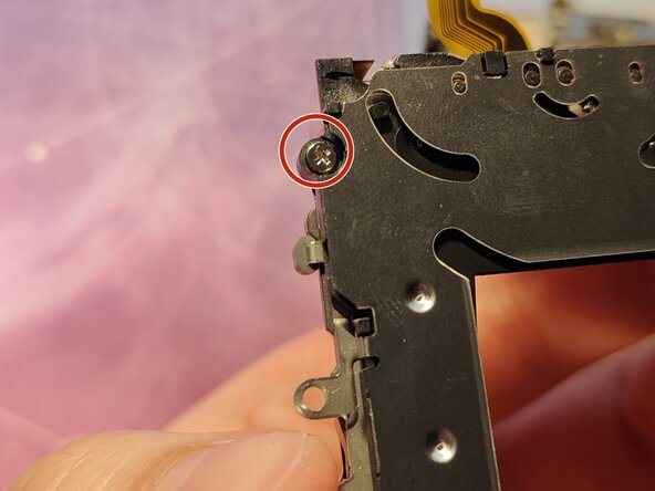

  34. Sony NEX-7 Sony NEX-7 Shutter Assembly Replacement, Removing the midframe 1: step 34, image 1 of 3 Sony NEX-7 Sony NEX-7 Shutter Assembly Replacement, Removing the midframe 1: step 34, image 2 of 3 Sony NEX-7 Sony NEX-7 Shutter Assembly Replacement, Removing the midframe 1: step 34, image 3 of 3
    • Gently lift up the sensor flex cables to reveal a screw underneath marked with red circles in Picture 1 and 2.
    • Remove this black M1.4 x 3.5 screw with a JIS 00 screwdriver.
    • Locate the flex cable shown in Picture 3 and before proceeding to the next step, please make sure you have successfully drained the flash capacitor, otherwise you risk electrocuting yourself.
    • To drain the capacitor I suggest using your multimeter and putting each probe on each draining pad marked with blue circles in Picture 3. Make sure it goes all the way down to ~ 5 volts.

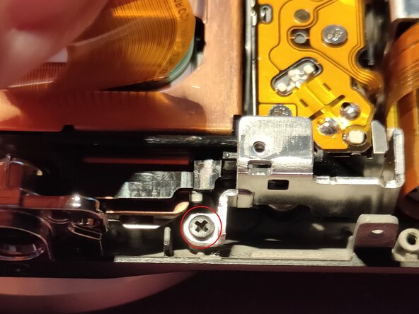

  35. Sony NEX-7 Sony NEX-7 Shutter Assembly Replacement, Removing midframe & battery compartment: step 35, image 1 of 3 Sony NEX-7 Sony NEX-7 Shutter Assembly Replacement, Removing midframe & battery compartment: step 35, image 2 of 3 Sony NEX-7 Sony NEX-7 Shutter Assembly Replacement, Removing midframe & battery compartment: step 35, image 3 of 3
    • Gently tilt down the flex cable as shown in Picture 1, and locate the screw marked with a red circle.
    • Remove this black M1.4 X 3.5 screw with a JIS 00 screwdriver.
    • Remove the big bracket containing the plastic door covering the ports on the left.
    • Remove the silver M1.7 X 4.0 (Tapping) screw with a JIS 00 screwdriver marked with a red circle in Picture 2.
    • Carefully lift out the battery compartment assembly, there is still one flex cable without any locking tabs (marked with an orange rectangle in Picture 3) connected.
    • Grab it firmly with your fingers and gently pull it out in the direction of the orange arrow.
    • Put the battery compartment aside.

    • Carefully lift the sensor out, making sure not to lose any adjusting washers which are between the sensor and the mounting holes.
    • They are all different sizes, you can see the washers in Picture 2 marked with blue circles, just make sure not to lose them.
    Ask FixBot
  37. Sony NEX-7 Sony NEX-7 Shutter Assembly Replacement, Removing the shutter assembly: step 37, image 1 of 3 Sony NEX-7 Sony NEX-7 Shutter Assembly Replacement, Removing the shutter assembly: step 37, image 2 of 3 Sony NEX-7 Sony NEX-7 Shutter Assembly Replacement, Removing the shutter assembly: step 37, image 3 of 3
    • Remove the remaining 3 M1.4 X 2.5 red screws with a JIS 00 screwdriver seen in Picture 1.
    • Remove the shutter and locate a small M1.6 X 4.5 (Tapping) silver screw marked with a red circle in Picture 2 holding the charge unit in place.
    • Transfer the charge unit assembly over to the new shutter unit, or simply replace the charge unit with a new working one, it depends on what replacement part you've bought.
