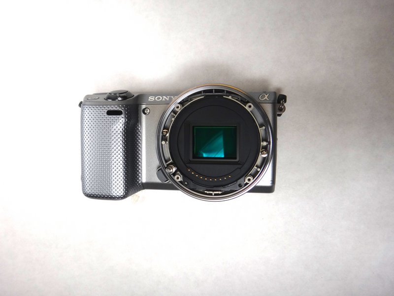

Replacing the lens mount requires removing any lens that is already attached then simply removing the casing of the lens mount.
Tools
    1. Sony NEX-5R Lens Mount Replacement, Lens Mount: step 1, image 1 of 2 Sony NEX-5R Lens Mount Replacement, Lens Mount: step 1, image 2 of 2
      • Hold lens and camera securely with two hands.
      • With the hand holding the camera, push down on the lens button. Twist the lens counterclockwise and pull out to release lens.
      Ask FixBot
    2. Sony NEX-5R Lens Mount Replacement: step 2, image 1 of 1
      • Using your screwdriver, remove the four (3.5 mm) Phillips screws on the front face of the lens mount.
      • Make sure to keep track of these screws and not misplace them.
      Ask FixBot
    3. Sony NEX-5R Lens Mount Replacement: step 3, image 1 of 1
      • Remove the silver plate by gently pinching with your fingers.
      Ask FixBot
    4. Sony NEX-5R Lens Mount Replacement: step 4, image 1 of 1
      • Now the black plate should be exposed. You can remove this again by gently pinching with your fingers and lifting up.
      Ask FixBot
    5. Sony NEX-5R Lens Mount Replacement: step 5, image 1 of 1
      Tool used on this step:
      Buy
      • Using the tweezers, grab the thin silver ring and lift up.
      Ask FixBot
    6. Sony NEX-5R Lens Mount Replacement: step 6, image 1 of 1
      • The camera mount should now be barren and look like this.
      Ask FixBot
