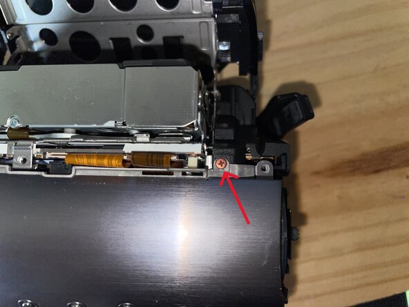

    3. Sony HDR-HC3 Camcorder Disassembly, Remove the "aluminum" part: step 3, image 1 of 1
      • Orange screw
      Ask FixBot
    4. Sony HDR-HC3 Camcorder Disassembly, Removing the aluminum part 2: step 4, image 1 of 2 Sony HDR-HC3 Camcorder Disassembly, Removing the aluminum part 2: step 4, image 2 of 2
      • CAUTION: Carefully disconnect the orange ribbon cable from the board.
      • Lift slightly until you can access the 2nd ribbon cable underneath.
