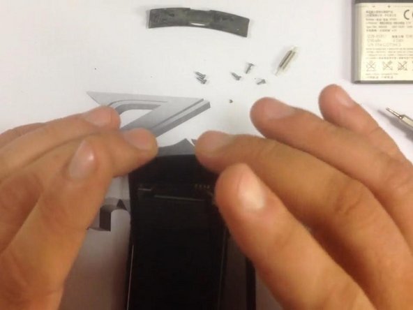

  1. Sony Ericsson Vivaz (U5) Digitizer Replacement, Change / Replace Touch Screen: step 1, image 1 of 3 Sony Ericsson Vivaz (U5) Digitizer Replacement, Change / Replace Touch Screen: step 1, image 2 of 3 Sony Ericsson Vivaz (U5) Digitizer Replacement, Change / Replace Touch Screen: step 1, image 3 of 3
    • First remove battery, sim card and memory card. You must remove seven screws.
