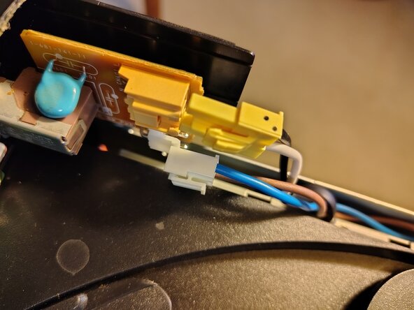

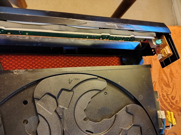

  2. Sony CDP-CE275 CD Player Belt Replacement, Remove front panel: step 2, image 1 of 3 Sony CDP-CE275 CD Player Belt Replacement, Remove front panel: step 2, image 2 of 3 Sony CDP-CE275 CD Player Belt Replacement, Remove front panel: step 2, image 3 of 3
    • Disconnect the yellow and white power connectors at the left side of the unit.
    • Disconnect the ribbon cable at the right side by pulling straight up.
    • To remove the front panel, depress small catches on each side, then tug gently on the panel. It is necessary to pull the left side out first so that the right side can be shifted past the right edge of the tray. Once the right side is clear the entire front panel can be pulled away from the unit.
    • Tip: After removing the front panel be careful not to slide the tray back into the unit. If it is returned to its locked position it won't open unless the power is on.
    Ask FixBot
    • Unscrew the single small screw in the center of the disc tray and lift off the tray.

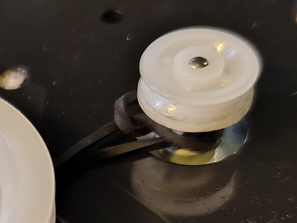

  3. Sony CDP-CE275 CD Player Belt Replacement, Replace the belt: step 4, image 1 of 3 Sony CDP-CE275 CD Player Belt Replacement, Replace the belt: step 4, image 2 of 3 Sony CDP-CE275 CD Player Belt Replacement, Replace the belt: step 4, image 3 of 3
    • Notice the defective belt in the photo has become wrapped around the small pulley. Identify the defective belt in your unit and remove it. A replacement belt can be purchased online, for example, https://www.amazon.com/dp/B08KWCN41C
    • Observe the correct placement of the belt in the next photo.
    Ask FixBot
To reassemble your device, follow these instructions in reverse order. Note that attaching the front plate requires the disc tray to be in its extended position so the front slot can be slipped around it.

Note that this only shows how to change the upper belt, which rotates the tray. There is another belt on the underside of the mechanism which opens/closes the tray.
