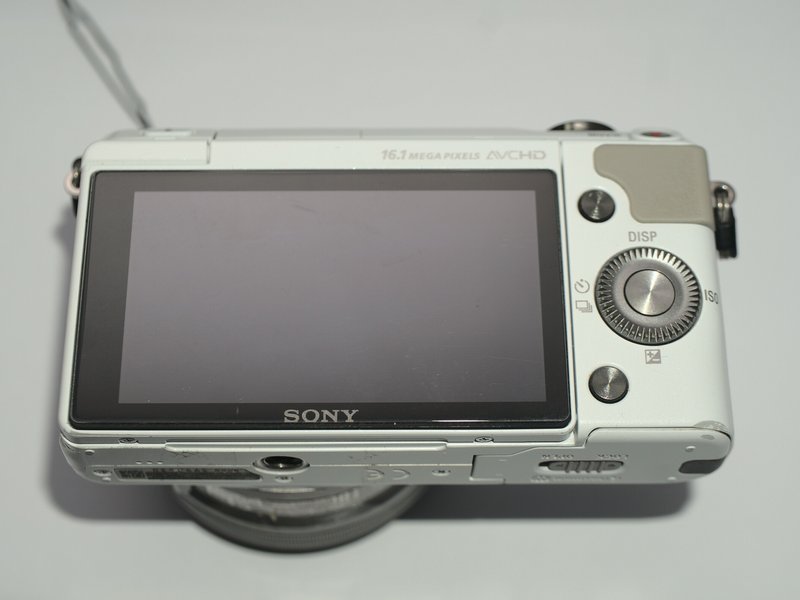

In this guide, you'll learn how to replace the LCD screen on the Sony Alpha NEX-3N, a component prone to cracking and breaking over the years.

      • Remove the battery and SD card from the bottom of the camera before starting any disassembly. This is not only to keep your image files safe, but to also prevent getting shocked by electronic components inside the camera.
