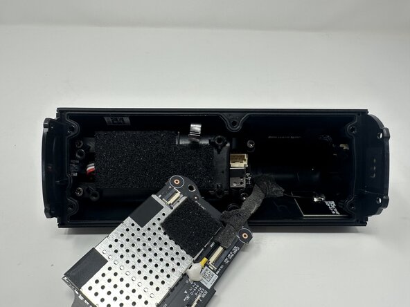

    • Pull the motherboard off of the battery case.
    • The motherboard wire encased in foam is partly attached to the speaker via a weak adhesive.
    • Gently pull the wire to break the adhesive.
  12. Sonos Roam 2 Motherboard Replacement: step 12, image 1 of 3 Sonos Roam 2 Motherboard Replacement: step 12, image 2 of 3 Sonos Roam 2 Motherboard Replacement: step 12, image 3 of 3
    • The wire is welded onto the speaker. Use the soldering iron to melt the metal keeping it on the speaker.
    • Completely remove the wire from the speaker. Remove the motherboard.
