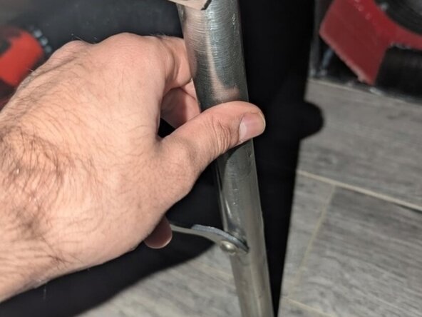

    2. SkyTech Nebula PCIe Wi-Fi Card Replacement: step 2, image 1 of 1
      • Set up your workspace on a hard, non-carpeted surface to minimize static electricity.
      • Ground yourself by touching a large, unpainted metal object (such as a metal table leg or radiator).
      • Do not skip this step. Grounding discharges static electricity, which protects sensitive internal components from permanent hardware damage.

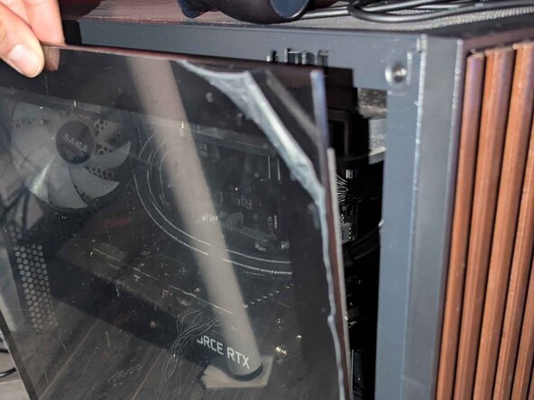

    3. SkyTech Nebula PCIe Wi-Fi Card Replacement: step 3, image 1 of 2 SkyTech Nebula PCIe Wi-Fi Card Replacement: step 3, image 2 of 2
      • Locate the groove on the top-left edge of the side panel to get a firm grip.
      • Pull the panel firmly toward you to pop it off the chassis.

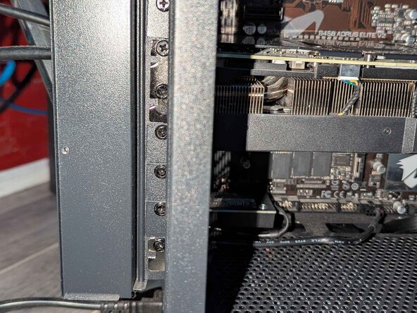

    4. SkyTech Nebula PCIe Wi-Fi Card Replacement: step 4, image 1 of 2 SkyTech Nebula PCIe Wi-Fi Card Replacement: step 4, image 2 of 2
      • Unscrew the small panel on rear of PC by hand which will reveal the retaining screw holding the Wi-Fi card in place.
      • The Wi-Fi card is a small card seated horizontally towards the bottom half of the motherboard with two thin antennas attached to it at the rear of the PC.

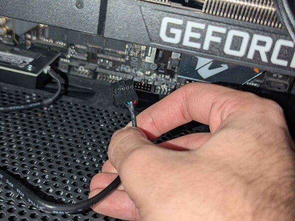

    6. SkyTech Nebula PCIe Wi-Fi Card Replacement: step 6, image 1 of 3 SkyTech Nebula PCIe Wi-Fi Card Replacement: step 6, image 2 of 3 SkyTech Nebula PCIe Wi-Fi Card Replacement: step 6, image 3 of 3
      • Gently disconnect the USB cable attached to the Wi-Fi card from the motherboard.
      • Remove the Wi-Fi card by pulling it out lightly.
      Ask FixBot
    7. SkyTech Nebula PCIe Wi-Fi Card Replacement: step 7, image 1 of 3 SkyTech Nebula PCIe Wi-Fi Card Replacement: step 7, image 2 of 3 SkyTech Nebula PCIe Wi-Fi Card Replacement: step 7, image 3 of 3
      • Seat the new Wi-Fi card back into place and connect the USB cable into the same header labeled USB it was removed from.
