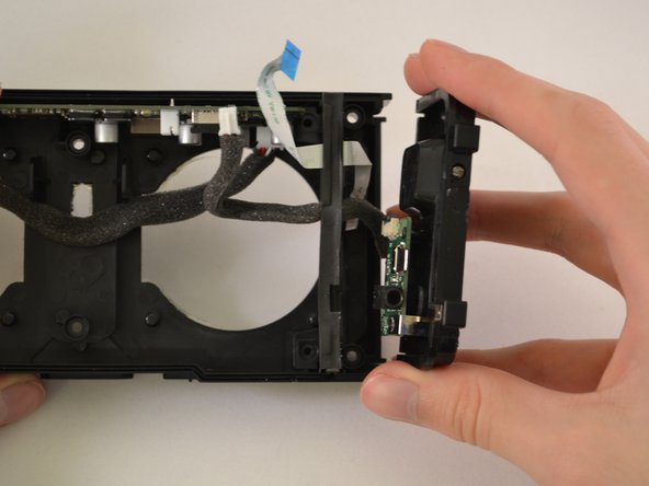

    3. Skullcandy Air Raid USB Board Replacement, Left Divider: step 17, image 1 of 3 Skullcandy Air Raid USB Board Replacement, Left Divider: step 17, image 2 of 3 Skullcandy Air Raid USB Board Replacement, Left Divider: step 17, image 3 of 3
      • Using a Phillips #00 Precision Screwdriver, unscrew two 6 mm screws from the left divider between the main cavity and the USB motherboard.
      • Pull out the USB/On Switch panel.
      • Pull out the Left Divider.
      • For reassembly, lift up on right side of motherboard to slide left divider back in place.
      Ask FixBot
    4. Skullcandy Air Raid USB Board Replacement, USB Motherboard: step 18, image 1 of 2 Skullcandy Air Raid USB Board Replacement, USB Motherboard: step 18, image 2 of 2
      • Using a Phillips #00 Precision Screwdriver, unscrew two 5 mm Phillips-head screws from the USB motherboard.
      • Remove the metal clip.
      Ask FixBot
