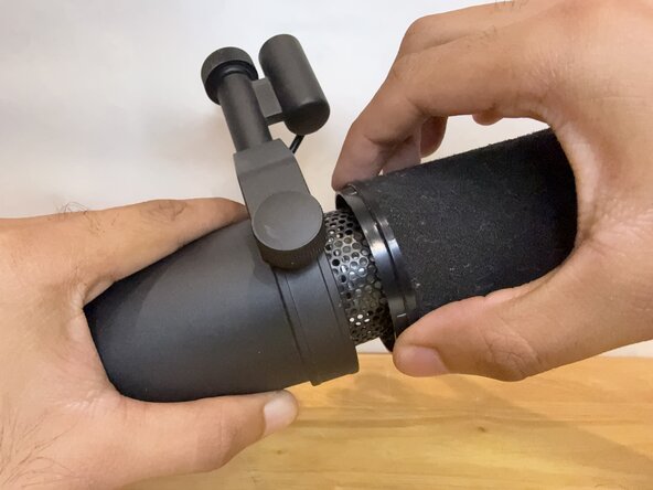

    • With one hand, grip the base of the microphone, and with the other, grip the plastic ring at the base of the windscreen.
    • Firmly pull the windscreen off the microphone; there should be little resistance when attempting this, and the windscreen will slide off the metal grille.

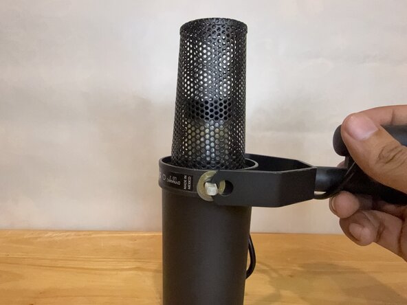

    • Remove the screw covers by twisting them counterclockwise.

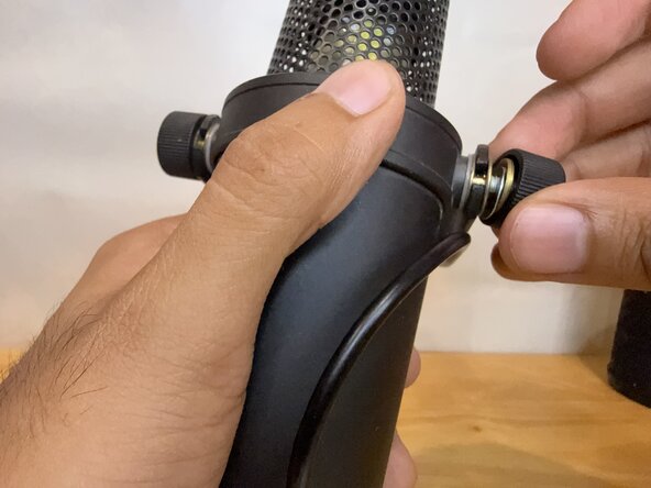

    • Remove the washers from the mounting screw.

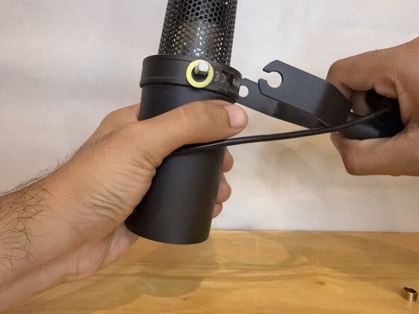

    • Remove the retaining ring from the mounting screw.
    • Remove the yoke bracket.
    • Remove the washers.
    • Removing the yoke bracket without aligning the slotted opening with the mounting screw is not possible.

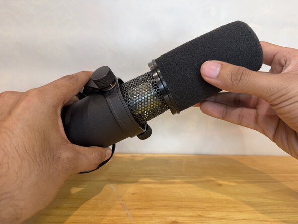

    • Slide the new windscreen onto the grille.
    • Grip the plastic ring at the base of the windscreen and firmly press it into place on the microphone.
    • You will have successfully installed the new windscreen when you hear a click sound.
