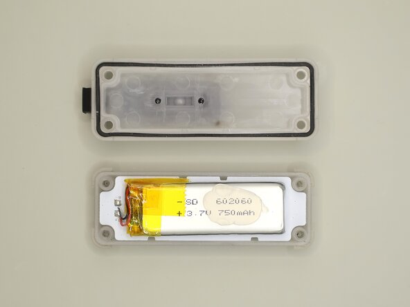

ShredLights rechargeable RGB LED lights mount to your skateboard or longboard to be visible at night. The SL-FX model, the predecessor to the SL-FX+, is not Bluetooth compatible.

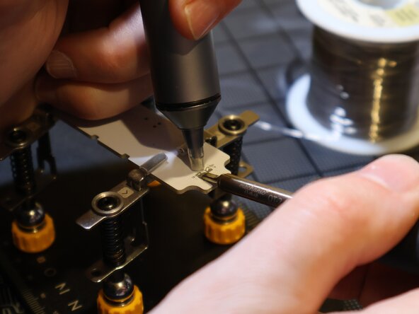

This guide shows how to reconnect the battery wire to the light. In this case the battery adhesive failed, after which the board vibrations caused the wires to fatigue and break off at the PCB interface. This repair requires basic soldering skills.
Below are some tutorials:
Tools
    1. ShredLights SL-FX Battery Reattachment, ShredLights SL-FX Battery Reattachment: step 1, image 1 of 3 ShredLights SL-FX Battery Reattachment, ShredLights SL-FX Battery Reattachment: step 1, image 2 of 3 ShredLights SL-FX Battery Reattachment, ShredLights SL-FX Battery Reattachment: step 1, image 3 of 3

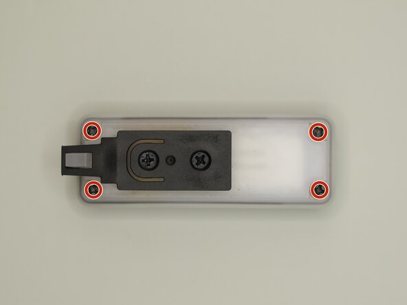

      • Using a Phillips #2 screwdriver, remove the four corner screws.
      • Remove the rear case half.
      • Ensure device is unplugged before repair.

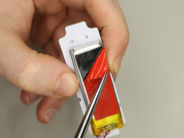

      • Remove the battery.
      • Peel off the old adhesive.
      • Be careful not to puncture the battery.

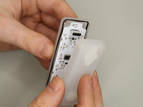

      • Remove the printed circuit board (PCB) from the front case half.
      Ask FixBot

      • Mount the PCB into a vice or helping hands.
      • De-solder the broken wire ends from the PCB.
      • Remove any solder from the through-hole pads.
      Ask FixBot
    6. ShredLights SL-FX Battery Reattachment: step 6, image 1 of 3 ShredLights SL-FX Battery Reattachment: step 6, image 2 of 3 ShredLights SL-FX Battery Reattachment: step 6, image 3 of 3
      • Solder the battery wires to the through-hole pads.
      • Clean off the excess flux using isopropanol.
      Ask FixBot

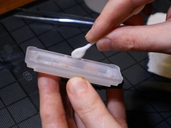

      • Remove the gasket from the rear case half.
      • Clean the gasket groove using isopropyl alcohol and a cotton swab.

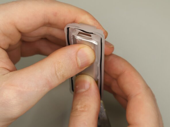

      • Peel off the backing film from the VHB tape on the battery.
      • Install PCB into the rear case half with the battery facing inwards, and press together with moderate force.

      • Install the four corner screws into the rear case half.
      Ask FixBot
