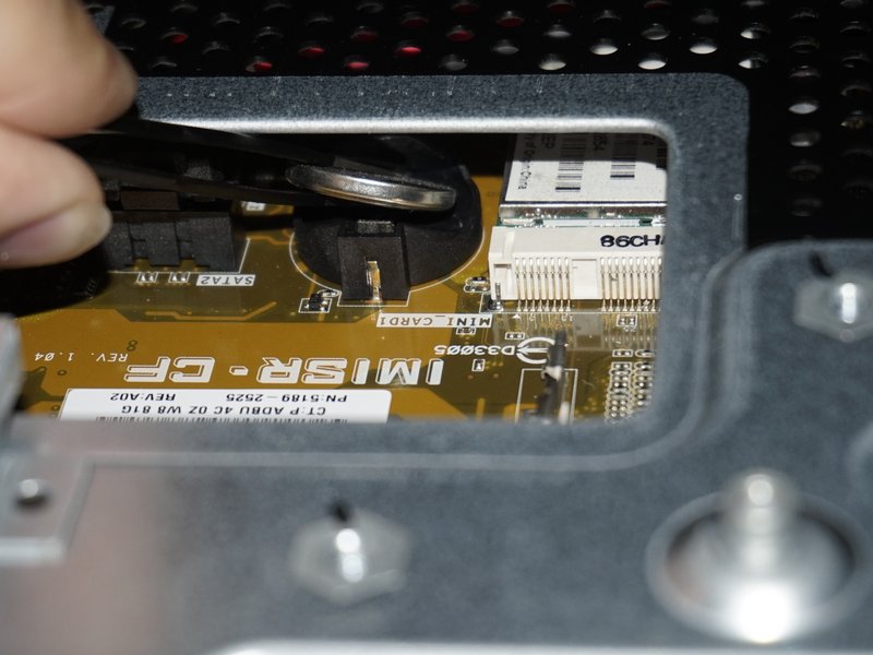

    7. Shortcut method - HP Touchsmart IQ506 CMOS Battery, Removing the battery: Part 1: step 8, image 1 of 2 Shortcut method - HP Touchsmart IQ506 CMOS Battery, Removing the battery: Part 1: step 8, image 2 of 2
      Tool used on this step:
      Buy
      • This is when the method used in this guide starts to get advanced. DO NOT CONTINUE unless you know how to disassemble the system should the battery fall in the system! IMPORTANT: Make sure you use blunt-ended tweezers.
      • Unclip the top of the battery using your fingernails. You do not need to use tweezers yet.
      Ask FixBot
    8. Shortcut method - HP Touchsmart IQ506 CMOS Battery, Removing the battery: Part 2: step 9, image 1 of 2 Shortcut method - HP Touchsmart IQ506 CMOS Battery, Removing the battery: Part 2: step 9, image 2 of 2
      • With the battery unclipped, use the tweezers to grab the battery. Pull the battery out while keeping a firm grip to avoid dropping it.

      • Make sure you do not drop the battery in the machine!
      • Open the new battery, and grab it with the tweezers. Do not grab too much so it will drop, but get enough you can keep a good grip on it.
      Ask FixBot
    11. Shortcut method - HP Touchsmart IQ506 CMOS Battery, Replacing the battery: Part 2: step 12, image 1 of 1
      • With the battery in the tweezers, slowly slide the battery in the clip. Once you have it in, put one finger on the battery while removing the tweezers.
      Ask FixBot
    12. Shortcut method - HP Touchsmart IQ506 CMOS Battery, Replacing the battery: Part 3: step 13, image 1 of 2 Shortcut method - HP Touchsmart IQ506 CMOS Battery, Replacing the battery: Part 3: step 13, image 2 of 2
      • With the battery in the clip, push down on the battery to lock it in the system.
      Ask FixBot

I’d put a piece of sticky tape on the top of the battery to keep it under control.
