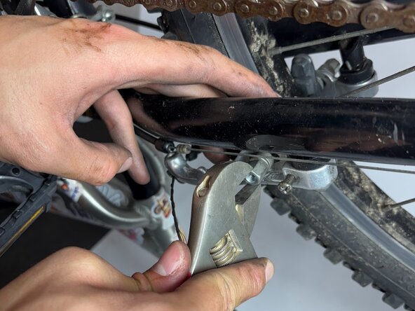

  2. Shimano Vertical PK7 Bike Back Wheel Replacement: step 2, image 1 of 3 Shimano Vertical PK7 Bike Back Wheel Replacement: step 2, image 2 of 3 Shimano Vertical PK7 Bike Back Wheel Replacement: step 2, image 3 of 3
    • Use the wrench to remove one side of the brakes on the back wheel.
    • The order of the nuts you remove go from left to right in the image provided.
    • Remember that to loosen a nut, you rotate it counterclockwise. To tighten, you rotate clockwise.

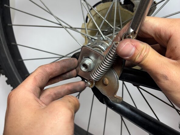

  5. Shimano Vertical PK7 Bike Back Wheel Replacement: step 5, image 1 of 3 Shimano Vertical PK7 Bike Back Wheel Replacement: step 5, image 2 of 3 Shimano Vertical PK7 Bike Back Wheel Replacement: step 5, image 3 of 3
    • Use the wrench to remove the nut. The bike stand will come free as well, so remove it and set it aside.

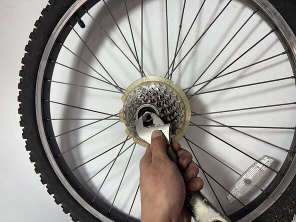

  6. Shimano Vertical PK7 Bike Back Wheel Replacement: step 6, image 1 of 3 Shimano Vertical PK7 Bike Back Wheel Replacement: step 6, image 2 of 3 Shimano Vertical PK7 Bike Back Wheel Replacement: step 6, image 3 of 3
    • Use one hand to lift up the gear chain to detach it from the cassette. Remove the wheel and set it aside.
    • The cassette refers to the stack of gears attached to the wheel.
    • Careful! Hands or the wheel axle may get caught on the chains.
