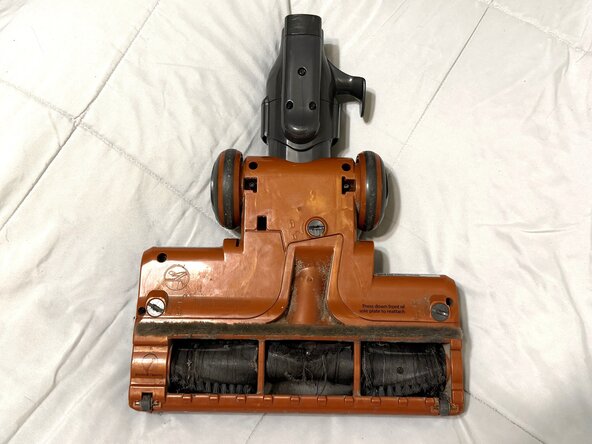

    2. Shark Rocket HV301 Vacuum Wheel Replacement: step 2, image 1 of 2 Shark Rocket HV301 Vacuum Wheel Replacement: step 2, image 2 of 2
      • Press the release button to detach the extension stick/wand from the main floor nozzle assembly.
      • Flip the floor nozzle over so the bottom brush roller plate is facing upward.

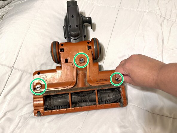

    3. Shark Rocket HV301 Vacuum Wheel Replacement: step 3, image 1 of 2 Shark Rocket HV301 Vacuum Wheel Replacement: step 3, image 2 of 2
      • Insert a coin (like a quarter) into the slot of each lock and turn it counterclockwise to the unlock position.
