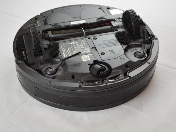

    1. Shark RV912 EZ Front Bumper Replacement, Front Bumper: step 1, image 1 of 1
      • Flip the robot over and power it off.
      Ask FixBot
    2. Shark RV912 EZ Front Bumper Replacement: step 2, image 1 of 1
      • Use a Torx Security TR8 screwdriver to remove the five 9.6 mm screws securing the bumper.
      Ask FixBot
    3. Shark RV912 EZ Front Bumper Replacement: step 3, image 1 of 1
      • Flip the robot upright, then lift the bumper and pull it toward you to remove it.
      Ask FixBot
