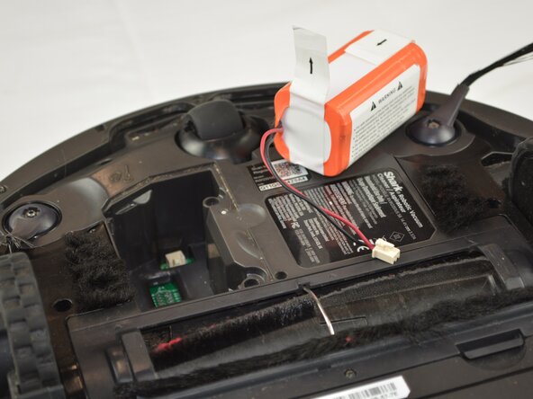

      • Power off the device using the power button located on the side of the device.
      • Flip the device over to expose the battery compartment.
      Ask FixBot
    2. Shark RV912 EZ Battery Replacement: step 2, image 1 of 2 Shark RV912 EZ Battery Replacement: step 2, image 2 of 2
      • Use the Phillips #2 screwdriver to remove the pair of 15.4 mm screws securing the battery cover.
      • Lift the battery compartment cover to expose the battery.
      Ask FixBot
    3. Shark RV912 EZ Battery Replacement: step 3, image 1 of 3 Shark RV912 EZ Battery Replacement: step 3, image 2 of 3 Shark RV912 EZ Battery Replacement: step 3, image 3 of 3
      • Use the tabs on the battery to lift it straight out to access the battery connector. Set the battery aside close to the battery compartment.
      • Do not pull on the battery while it is still connected to the device.
      • Use your fingers to squeeze the connector tab and remove it from the socket.
      • Remove the battery.
      Ask FixBot
To reassemble your device, follow these instructions in reverse order. Take your e-waste to an R2 or e-Stewards certified recycler.
