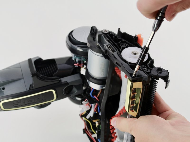

    1. Shark Flex DuoClean LED Headlight Replacement, LED Headlight: step 6, image 1 of 1
      • Turn the T10 Security Torx screwdriver counterclockwise to remove the 15mm screw.
      Ask FixBot

    3. Shark Flex DuoClean LED Headlight Replacement: step 8, image 1 of 2 Shark Flex DuoClean LED Headlight Replacement: step 8, image 2 of 2
      Ask FixBot
