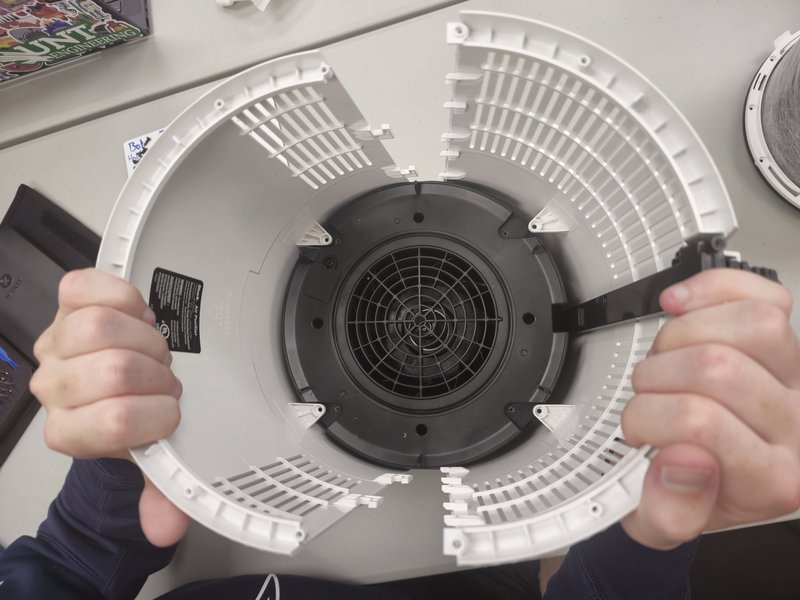

The Shark Clean Sense Air Purifier has a hard protective shell that keeps its components safe. This is a prerequisite guide for disassembling the device to get to certain parts and can be used as a guide to replace the shell.
    1. Shark Clean Sense HP102PET Shell Replacement, Outer White Shell: step 1, image 1 of 3 Shark Clean Sense HP102PET Shell Replacement, Outer White Shell: step 1, image 2 of 3 Shark Clean Sense HP102PET Shell Replacement, Outer White Shell: step 1, image 3 of 3
      • Turn off and unplug the air purifier before beginning.
      • Unscrew the one 1.2 cm screw holding the grate at the top with a TR10 Torx screwdriver.
      • Use a prying tool to carefully pry along the outer edges to disengage the inner retaining clips.
      • These retaining clips can be difficult to disengage, but releasing two clips on the same side should allow you to easily remove the grate.
      • Remove the grate.

    7. Shark Clean Sense HP102PET Shell Replacement: step 7, image 1 of 3 Shark Clean Sense HP102PET Shell Replacement: step 7, image 2 of 3 Shark Clean Sense HP102PET Shell Replacement: step 7, image 3 of 3
      • Make sure that you are pulling up on the side that allows, as pictured in the red box.
      • Gently slide the cases up and down, or hold one and gently pull up on the opposite side (Down on the left, up on the right for this picture).
      • The whole case will start to separate and the black disc will come loose. This is normal.
      Ask FixBot
    8. Shark Clean Sense HP102PET Shell Replacement: step 8, image 1 of 3 Shark Clean Sense HP102PET Shell Replacement: step 8, image 2 of 3 Shark Clean Sense HP102PET Shell Replacement: step 8, image 3 of 3
      • Gently open the case outwards as there are fragile electronics inside.
      • Remove the fan housing.
