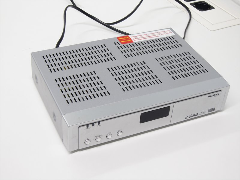

The box has a dysfunctioning pushbutton. This repairment guide shows a step by step guideline how to replace the button. By following the steps the user will apply the right proceedings and receive tips how to make the steps easier. By clicking the link shown below, the guide will be presented.
    1. Set-Top Box Numb Button Replacement, Numb Button: step 1, image 1 of 3 Set-Top Box Numb Button Replacement, Numb Button: step 1, image 2 of 3 Set-Top Box Numb Button Replacement, Numb Button: step 1, image 3 of 3
      • Make sure the box is not plugged in before starting!
      • Remove the 5 screws holding the outer casing in place: 3 can be found on the back and 1 on either side of the box.
      • Slide the casing backwards.
