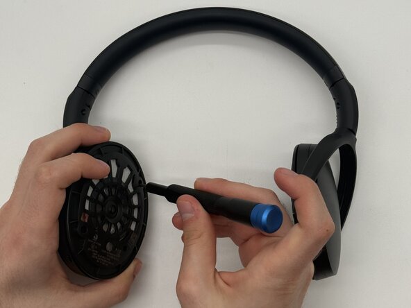

Sennheiser HD 350BT Motherboard Replacement
  1. Sennheiser HD 350BT Motherboard Replacement, Motherboard: step 1, image 1 of 2 Sennheiser HD 350BT Motherboard Replacement, Motherboard: step 1, image 2 of 2
    • Remove the right ear pad.
    Ask FixBot
  2. Sennheiser HD 350BT Motherboard Replacement: step 2, image 1 of 3 Sennheiser HD 350BT Motherboard Replacement: step 2, image 2 of 3 Sennheiser HD 350BT Motherboard Replacement: step 2, image 3 of 3
    • Remove the seven Phillips screws securing the driver housing.
    Ask FixBot
  3. Sennheiser HD 350BT Motherboard Replacement: step 3, image 1 of 2 Sennheiser HD 350BT Motherboard Replacement: step 3, image 2 of 2
    • Remove all of the Phillips screws securing the motherboard.
    • Desolder and disconnect all motherboard connections.
