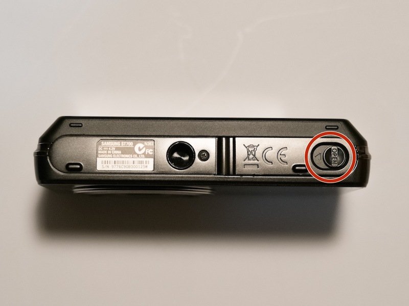

    1. Samsung ST700 Battery Replacement, Battery: step 1, image 1 of 1
      • The battery is located on the bottom of the camera underneath a latch door
      • To open the latched door, move the latch (circled in the picture) toward the center of the camera, and the door should pop open.
