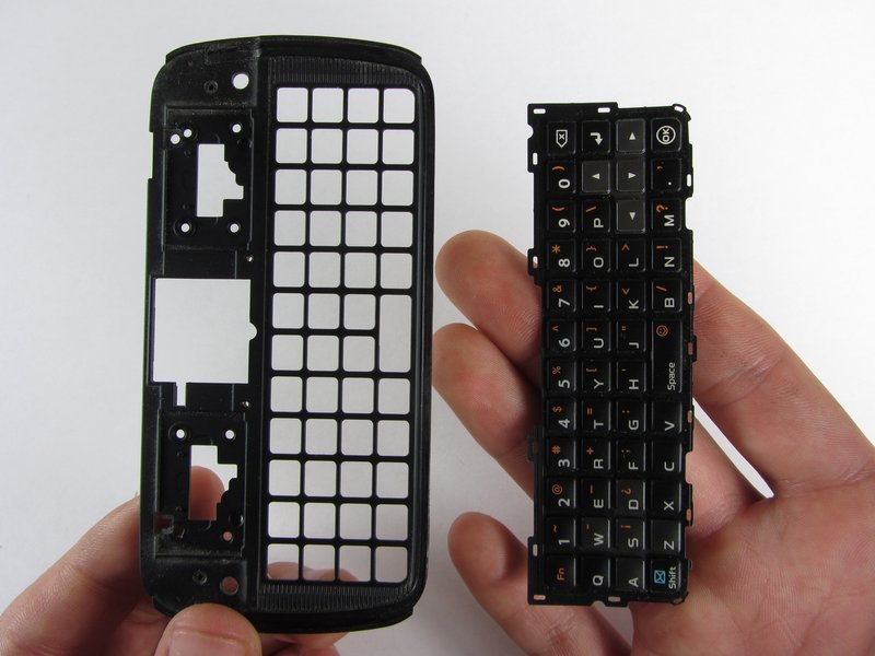

    1. Samsung Rogue Keyboard Replacement, Keyboard: step 9, image 1 of 1
      • Remove the eight 1.7mm Philips screws above the keyboard.
      Ask FixBot
    2. Samsung Rogue Keyboard Replacement: step 10, image 1 of 1
      • Carefully remove keyboard holder from the slider mechanisms underneath.
      Ask FixBot
    3. Samsung Rogue Keyboard Replacement: step 11, image 1 of 2 Samsung Rogue Keyboard Replacement: step 11, image 2 of 2
      • Turn keyboard holder over and allow the keyboard to simply fall out into your hand.
      Ask FixBot
