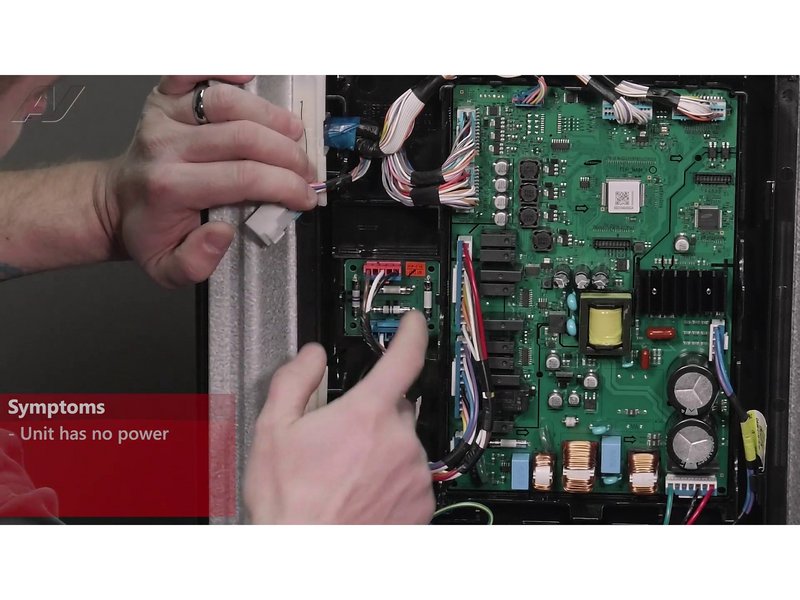

If your Samsung French Door refrigerator has no power, you may need to check, and possibly replace, the fuse block module. See step-by-step instructions below.
This guide will work for with many refrigerator models. The photos in this guide are from a Samsung RF28R7351SG/AA refrigerator. If you have a different model, you may encounter some minor disassembly differences, but the overall repair process will be the same. This guide shows the replacement of part number DA92-00945F which is compatible with other popular models such as RF28R7201SR/AA, RF28R7351SG/AA, RF24R7201SR/AA, RF28R6201SR/AA, RF18HFENBSR/US, plus many other Samsung models.

      • With the panel removed, you now have clear access to the fuse block.
      Ask FixBot
    5. Samsung RF28R7351 Fuse Block Module Replacement, Test continuity of fuses: step 5, image 1 of 2 Samsung RF28R7351 Fuse Block Module Replacement, Test continuity of fuses: step 5, image 2 of 2
      • The main reason why you'd be accessing your fuse block is if the unit has no power
      • Once the fuse block is removed, you can use your multimeter to test continuity on the metal sides of each one of these fuses.
      • (How to use a multimeter)
      • If one is blown, the fuse block will need to be replaced.
      Ask FixBot

      • When installing your new fuse block, first install the wiring.
      • Make sure the connector is securely locked into place.
      • The red wire goes with the red, and the blue with the blue.
      • Swing it in at an angle and pop it in place.
