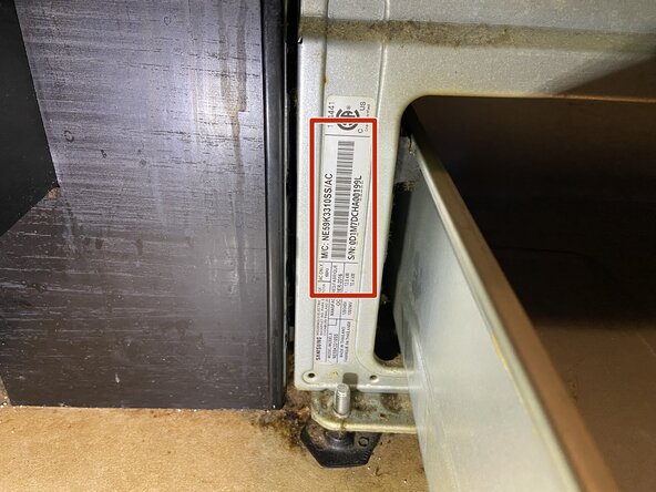

    • Open the warming drawer and confirm the stove model (NE59K3310SS) at the bottom left corner of the stove before purchasing a new Dual Surface Element Control Switch.

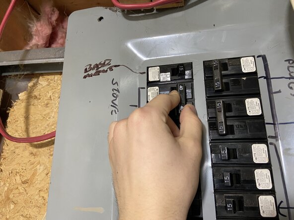

  3. Samsung NE59K3310SS Range Dual Surface Element Control Switch Replacement: step 3, image 1 of 2 Samsung NE59K3310SS Range Dual Surface Element Control Switch Replacement: step 3, image 2 of 2
    • Find the breaker switch for your stove and flip it to the “off” position. Confirm that the stove is not receiving power.

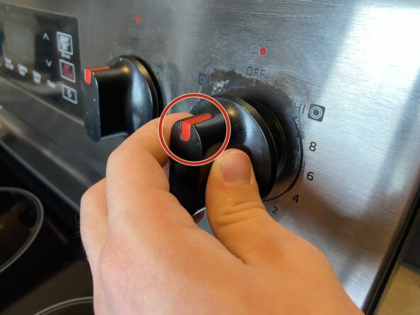

  13. Samsung NE59K3310SS Range Dual Surface Element Control Switch Replacement: step 13, image 1 of 2 Samsung NE59K3310SS Range Dual Surface Element Control Switch Replacement: step 13, image 2 of 2
    • Hold the knob with the red indicator in “up” position.
    • Slide the knob back on the new switch shaft.
