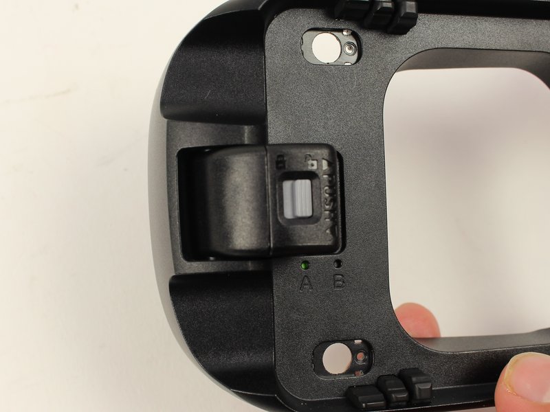

If your phone doesn't have a compatible USB port or if the USB connector breaks, use this guide to swap the connector out for a new one. The Samsung Gear VR can hold a USB Type-C or Micro USB. This guide requires no tools.
    1. Samsung Gear VR With Controller USB Connector Replacement, USB Connector: step 1, image 1 of 3 Samsung Gear VR With Controller USB Connector Replacement, USB Connector: step 1, image 2 of 3 Samsung Gear VR With Controller USB Connector Replacement, USB Connector: step 1, image 3 of 3
      • Push the switch on the right-hand side of the device to separate the cover from the main body.
      • Pull the cover away from the main device.
      Ask FixBot
    2. Samsung Gear VR With Controller USB Connector Replacement: step 2, image 1 of 3 Samsung Gear VR With Controller USB Connector Replacement: step 2, image 2 of 3 Samsung Gear VR With Controller USB Connector Replacement: step 2, image 3 of 3
      • Slide the gray switch to the right to unlock the USB connector.
      • Lift the connector perpendicular to the device.
      • Slide off the USB connector gently with your fingers.
