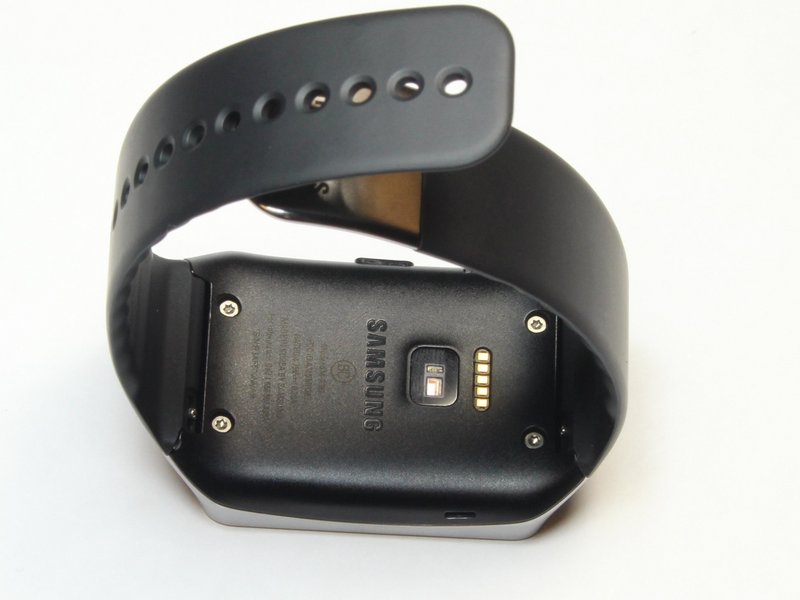

    1. Samsung Gear Live Watchband Replacement, Lay the watch face-down: step 1, image 1 of 1
      • Lay the watch face-down on a flat, stable surface.
      Ask FixBot
    2. Samsung Gear Live Watchband Replacement, Remove the holding pin: step 2, image 1 of 1
      • Press the watchband down against the work surface.
      • Press the tip of a flathead screwdriver against the edge of the spring-loaded holding pin.
      Ask FixBot
    3. Samsung Gear Live Watchband Replacement, Remove the watchband: step 3, image 1 of 1
      • With the spring-loaded pin pressed in, the watch band should release easily.
      • Gently pull the band away from the body of the watch.
      • Repeat steps 2 and 3 for the opposite side.
      Ask FixBot
