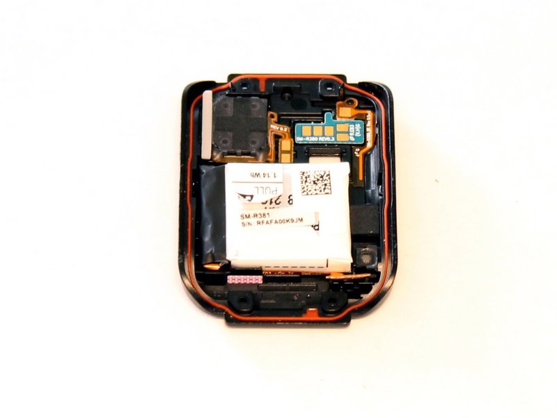

    4. Samsung Gear 2 Neo  Battery Replacement: step 4, image 1 of 1
      • Once separated, the back half of the device is easily distinguished from the front by the large white battery. Take a moment to familiarize yourself with the important components presented in this half of the device before continuing.
      • 300 mAh Battery
      • Battery Connector (attached by way of adhesive)
      • Device Speaker.
      • Be aware that the orange lining around the edge of the device forms part of the seal that prevents moisture from entering the main assembly. Be careful to not disturb this lining or the Gear 2 Neo will become dramatically less water resistant.

    5. Samsung Gear 2 Neo  Battery Replacement, Removing the Battery: step 5, image 1 of 3 Samsung Gear 2 Neo  Battery Replacement, Removing the Battery: step 5, image 2 of 3 Samsung Gear 2 Neo  Battery Replacement, Removing the Battery: step 5, image 3 of 3
      • To remove the battery, simply use the provided tab labeled "pull" to separate the battery from the casing. Do not pull the battery all the way out quite yet; there is still the matter of detaching the battery connector.
      • There is a small application of adhesive on the underside of the battery. When lifting the battery away, if you feel a bit of resistance, feel free to press down on the casing to give yourself a bit of leverage.
      • Caution: Be very careful not to puncture the battery in this step or while recycling; doing so can result in the release of dangerous gases and an explosive reaction.
      • Finally, using a spudger, separate the end of the battery connector cable, (held in place by another small application of adhesive and a plastic pin) from the casing.
