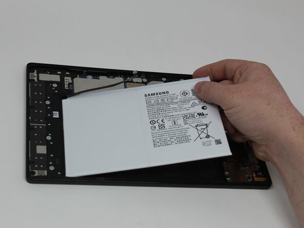

    1. Samsung Galaxy Tab A8 Battery Replacement, Battery: step 6, image 1 of 1
      • Remove the four adhesive tape strips from the battery.
      • If your battery doesn't have adhesive tabs or tape, apply heat to soften the glue holding the battery in place. Be careful not to overheat the battery.
      Ask FixBot
    2. Samsung Galaxy Tab A8 Battery Replacement: step 7, image 1 of 2 Samsung Galaxy Tab A8 Battery Replacement: step 7, image 2 of 2
      • Remove the battery.
