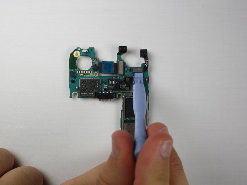

    1. Samsung Galaxy S5 Mini Front-Facing Camera Replacement, Front-Facing Camera: step 15, image 1 of 3 Samsung Galaxy S5 Mini Front-Facing Camera Replacement, Front-Facing Camera: step 15, image 2 of 3 Samsung Galaxy S5 Mini Front-Facing Camera Replacement, Front-Facing Camera: step 15, image 3 of 3
      • Use a plastic opening tool or spudger to pry off the front-facing camera from the motherboard.
