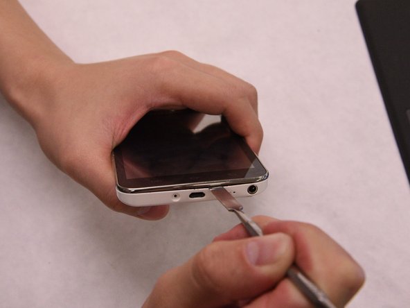

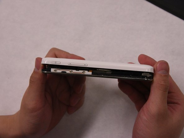

  3. Samsung Galaxy Player 5.0 Screen Replacement: step 3, image 1 of 3 Samsung Galaxy Player 5.0 Screen Replacement: step 3, image 2 of 3 Samsung Galaxy Player 5.0 Screen Replacement: step 3, image 3 of 3
    • Starting from the bottom, use a pry tool to separate the front housing cover from the back cover.
    • Use a plastic prying tool if you can. Be extremely careful when separating the front housing cover.
    • Pull the front and back cover halves apart completely.
