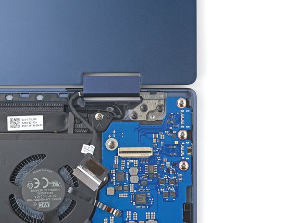

    1. Samsung Galaxy Book Pro 360 15" Screen Replacement, Disconnect the display cable's ZIF connector: step 9, image 1 of 2 Samsung Galaxy Book Pro 360 15" Screen Replacement, Disconnect the display cable's ZIF connector: step 9, image 2 of 2
      • Use the flat end of a spudger to pry up the locking flap on the right display cable's ZIF connector.
      Ask FixBot
    2. Samsung Galaxy Book Pro 360 15" Screen Replacement, Disconnect the display cable: step 10, image 1 of 2 Samsung Galaxy Book Pro 360 15" Screen Replacement, Disconnect the display cable: step 10, image 2 of 2
      Tool used on this step:
      Buy
      • Use tweezers or your fingers to grip the display cable's pull tab and gently pull the cable out of its socket on the motherboard.
      Ask FixBot
    3. Samsung Galaxy Book Pro 360 15" Screen Replacement, Remove the display cable from its recess: step 11, image 1 of 2 Samsung Galaxy Book Pro 360 15" Screen Replacement, Remove the display cable from its recess: step 11, image 2 of 2
      • Slowly pull the right display cable out of its recess.
      • A small clip secures the cable.
      • During reassembly, make sure that the display cable is secured under its clip.
      Ask FixBot
    4. Samsung Galaxy Book Pro 360 15" Screen Replacement, Disconnect and remove the left display cable: step 12, image 1 of 1
      • Repeat the disconnection and removal procedure on the left display cable.
      Ask FixBot

    6. Samsung Galaxy Book Pro 360 15" Screen Replacement: step 14, image 1 of 2 Samsung Galaxy Book Pro 360 15" Screen Replacement: step 14, image 2 of 2
      • Use a Phillips screwdriver to remove the three 3.6 mm screws securing the right screen hinge.
      • During reassembly, install the screws from left to right.
      Ask FixBot
    7. Samsung Galaxy Book Pro 360 15" Screen Replacement: step 15, image 1 of 2 Samsung Galaxy Book Pro 360 15" Screen Replacement: step 15, image 2 of 2
      • Use a Phillips screwdriver to remove the three 3.6 mm screws securing the left screen hinge.
      • During reassembly, install the screws from right to left.
      Ask FixBot
