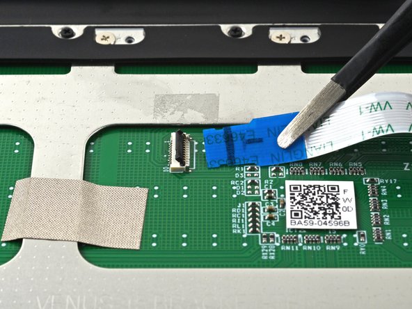

    1. Samsung Galaxy Book Pro 15" Touchpad Replacement, Remove the tape: step 9, image 1 of 2 Samsung Galaxy Book Pro 15" Touchpad Replacement, Remove the tape: step 9, image 2 of 2
      Tool used on this step:
      Buy
      • Use tweezers, or your fingers, to peel back and remove the yellow tape covering the touchpad's cable connector.
      Ask FixBot
    2. Samsung Galaxy Book Pro 15" Touchpad Replacement, Disconnect the touchpad: step 10, image 1 of 2 Samsung Galaxy Book Pro 15" Touchpad Replacement, Disconnect the touchpad: step 10, image 2 of 2
      • Use a spudger to gently pry up the locking flap on the ZIF connector for the touchpad cable.
      Ask FixBot
    3. Samsung Galaxy Book Pro 15" Touchpad Replacement: step 11, image 1 of 2 Samsung Galaxy Book Pro 15" Touchpad Replacement: step 11, image 2 of 2
      • Disconnect the touchpad cable by sliding it out from its socket on the touchpad.
      Ask FixBot

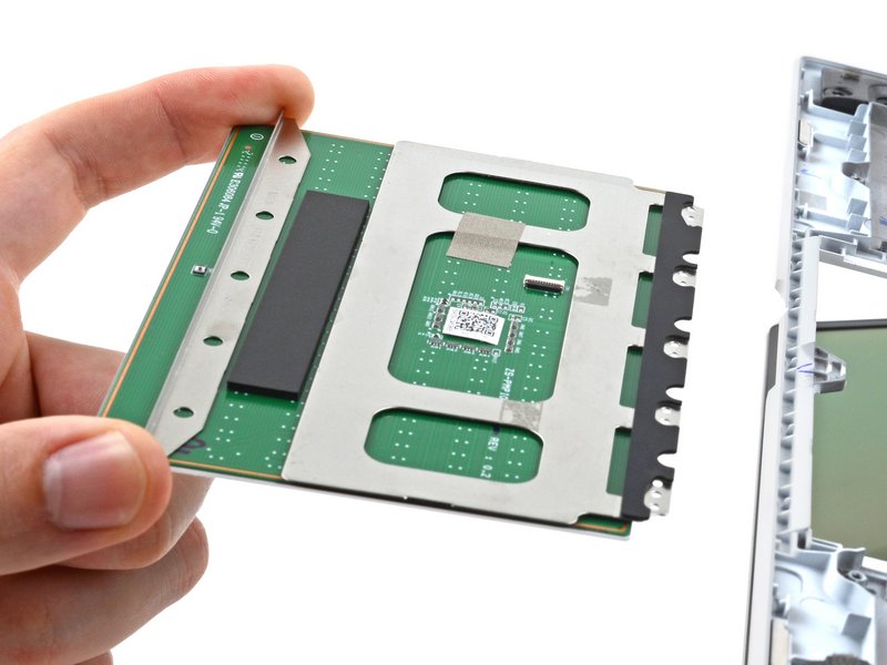

    6. Samsung Galaxy Book Pro 15" Touchpad Replacement, Remove the touchpad: step 14, image 1 of 3 Samsung Galaxy Book Pro 15" Touchpad Replacement, Remove the touchpad: step 14, image 2 of 3 Samsung Galaxy Book Pro 15" Touchpad Replacement, Remove the touchpad: step 14, image 3 of 3
      • Swing the display open slightly, but keep the laptop upside-down.
      • Tilt the touchpad upwards and away from the frame.
      • Pull the touchpad towards the top of the laptop to separate it from its recess in the frame.
      • Remove the touchpad.
