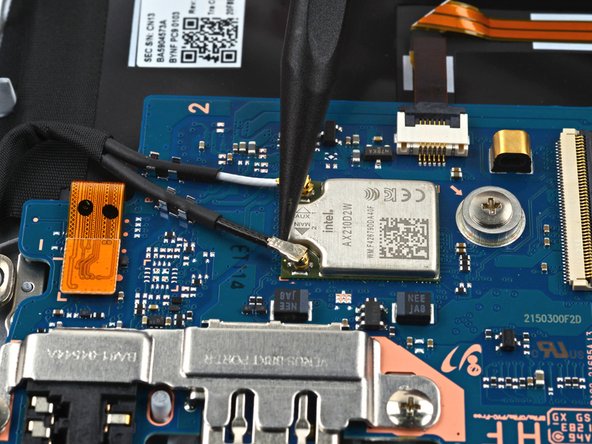

    3. Samsung Galaxy Book Pro 15" Screen Replacement, Disconnect the antenna: step 9, image 1 of 3 Samsung Galaxy Book Pro 15" Screen Replacement, Disconnect the antenna: step 9, image 2 of 3 Samsung Galaxy Book Pro 15" Screen Replacement, Disconnect the antenna: step 9, image 3 of 3
      • Use the tip of a spudger to pry up and disconnect the two WLAN antenna cables.
      • Pry under the bottom of the cable's metal head and not the cable itself.
      • During reassembly, these can be tricky to reconnect. One at a time, hold each connector in place over its socket and press down with the flat end of a spudger. The connector should snap into place.
