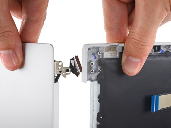

Use this guide to replace the front case in your Galaxy Book Pro 15" Laptop.
This guide is written for the front case. The front case consists of the keyboard, touchpad, and fingerprint sensor pre-installed into the frame.
For your safety, discharge the battery below 25% before disassembling your device. This reduces the risk of a thermal event if the battery is accidentally damaged during the repair. If your battery is swollen, take appropriate precautions.
Note: Some photos show the heat sink and the primary SSD removed. This is optional, as you don't need to remove the heat sink or the primary SSD to remove the motherboard.

    7. Samsung Galaxy Book Pro 15" Front Case Replacement, Disconnect the keyboard: step 32, image 1 of 2 Samsung Galaxy Book Pro 15" Front Case Replacement, Disconnect the keyboard: step 32, image 2 of 2
      • Use a spudger to gently pry up the locking flap on the ZIF connector for the keyboard cable.
      Ask FixBot
    8. Samsung Galaxy Book Pro 15" Front Case Replacement: step 33, image 1 of 2 Samsung Galaxy Book Pro 15" Front Case Replacement: step 33, image 2 of 2
      • Disconnect the keyboard cable by sliding it out from its socket on the motherboard.
      Ask FixBot
    9. Samsung Galaxy Book Pro 15" Front Case Replacement, Disconnect the display: step 34, image 1 of 2 Samsung Galaxy Book Pro 15" Front Case Replacement, Disconnect the display: step 34, image 2 of 2
      Ask FixBot
    10. Samsung Galaxy Book Pro 15" Front Case Replacement: step 35, image 1 of 2 Samsung Galaxy Book Pro 15" Front Case Replacement: step 35, image 2 of 2
      • Disconnect the display cable by sliding it out from its socket on the motherboard.

    6. Samsung Galaxy Book Pro 15" Front Case Replacement, Remove the screen: step 47, image 1 of 3 Samsung Galaxy Book Pro 15" Front Case Replacement, Remove the screen: step 47, image 2 of 3 Samsung Galaxy Book Pro 15" Front Case Replacement, Remove the screen: step 47, image 3 of 3
      • Keep a firm grip on both the screen and frame of the laptop. Either half can fall unexpectedly during this step.
      • Push both halves of the laptop together so that the hinges can be lifted clear of their recesses in the frame.
      • Push the frame of the laptop away from you while pulling the screen toward you to separate it.
      Ask FixBot
    7. Samsung Galaxy Book Pro 15" Front Case Replacement: step 48, image 1 of 1
      • Remove the screen.
      • During reassembly, first install the hinge screws without tightening them fully. Then adjust the screen until it's correctly centered and aligned on each side. Finally, tighten the screws.
      Ask FixBot
